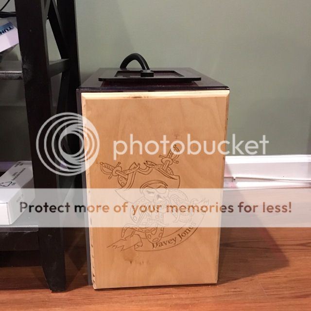

Davey Jones Locker
I made the following to cover an ATO (Auto Top Off) reservoir that I use for a salt water aquarium.

Davey Jones Locker
