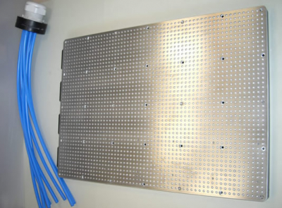

Postby Ms Wolffie » Sat Nov 08, 2014 5:04 am
http://www.sorotec.de/shop/product_info.php/info/p1531_vacuum-table-600mm-x-420mm-sorotec-edition.html
I just bought this vacuum table but the company carries several others. The price is minus 19 percent tax so it is reasonable.
http://www.sorotec.de/shop/index.php/cat/c177_Vacuum-Tables-Vacuum-Tables.html
German quality.
