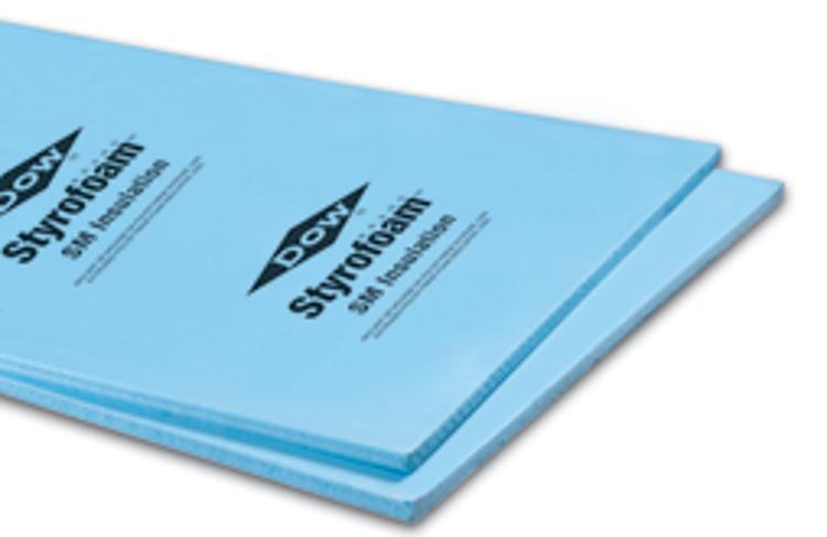

Expanded PVC is pretty much any PVC that comes in flat sheets.
Is it the expanded polystyrene like this?
Or is it extruded like this -- either pink or blue, depending on the manufacturer?
- Randall Newcomb

It's standard PVC board. Just like the PVC trim boards that you can get at Home Depot or Lowe's, etc. Except we get it in 4x8 sheets ( or larger) by the skid load.
The blue and pink stuff is (to me) called foam board

The standard "blue stuff" is called XPS, extruded poly styrene, its nasty cousin is polystyrene (styrofoam) like coffee cups are made of with all the little balls of foam bonded into a sheet/shape. Its commonly used in garage door fill in the US. XPS is used outside foundations for exterior insulation and is much more dense than polystyrene. The material from Lowes and Home Depot (home depot) is Royal as I believe Royal has the national contract with Home Depot for PVC trim. Its a product similar to Azek but lower quality. Its a foam core PVC sheet that is extruded so it has a hard skin on each face, one smooth-ish and one textured.
